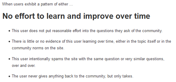

 Betreff des Beitrags: no effort to learn or improve over time
