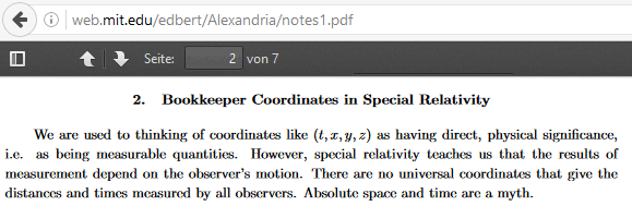

We must therefore be very careful how we physically interpret relations expressed in bookkeeper coordinates, since these coordinates do not accurately measure radial distance or separations in time.
