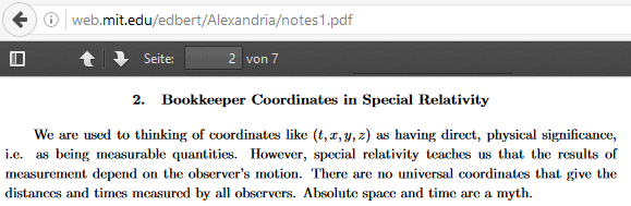

BeitragVerfasst: Mo 22. Aug 2016, 14:09
fb557 hat geschrieben:
We must therefore be very careful how we physically interpret relations expressed in bookkeeper coordinates, since these coordinates do not accurately measure radial distance or separations in time.
Dazu empfiehlt sich folgender Beitrag: viewtopic.php?p=111126#p111126
Empfehlend,
